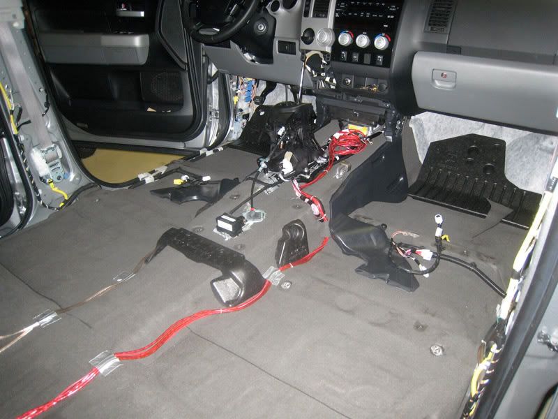

First thing first, truck is gutted and covered wall to wall with Dynamat Extreme, followed by a layer of Ensolite.
With the truck apart, the signal, power and speaker wires are run
