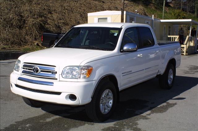

    How hard is it to take off the chrome mirror caps on the backside of the mirrors? Like these:
    I have been trying to get most of my chrome parts either black or white so I'd like to find some white ones.
    I want these:
    *If someone has some white ones off of the limited edition DC tundra's and wants to trade. Give me a shout! And send me some pictures if you can.

    I have an 05 limited in white. I destroyed my passenger mirror backing out of my garage.
    I bought a new one all white for $68.00 from toyotapartszone.com.

    does Plastidip make white? you could paint them.

    @bgeorge: do you happen to know the part number that you used? I searched through that part catalog for a while and couldn't find the correct part.
    I'm hoping someone will come along that wants the chrome ones and might be willing to trade.
    I thought about just painting them but Toyota has a specific white that they use and I don't think that just any white will match. I think it has to be Aspen white I think

    They do make white plasti dip if you wanted to cover all that chrome up ASAP. Then you can peel it off when you find new parts or a trade.

    NOT HEATED RH #87910-0C050-A0 and the LH #87910-0C120-A0.
    HEATED RH #87940-0C050-A0 and LH #87940-0C110-A0
    The cost is a lot higher then I remember paying 3 years ago. These are all in white.
    You may be able to find them cheaper using the part numbers. I had to remove the upper part of the inside panel to remove the nuts that held the mirror on and unplug the wires.
