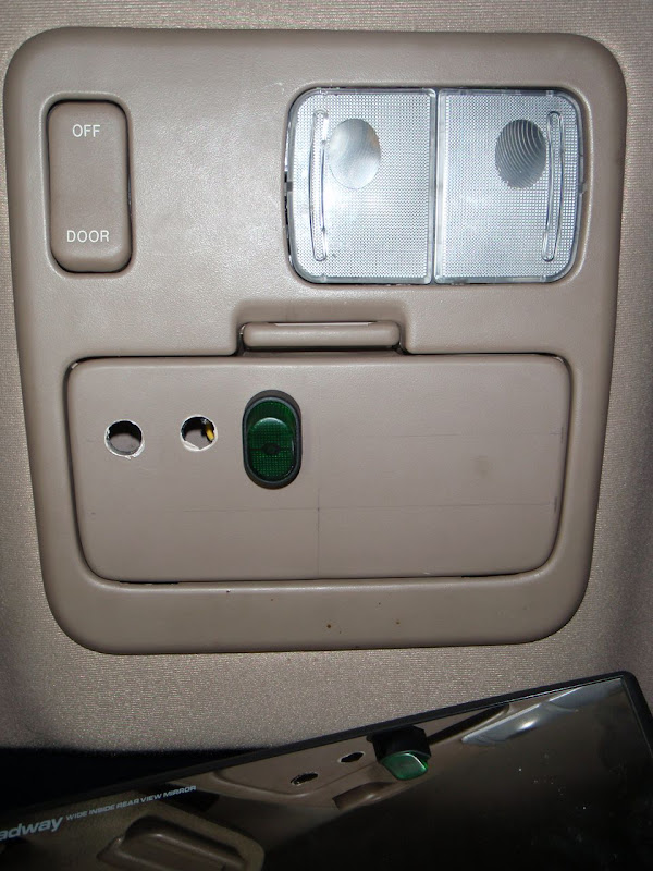

Decided to add two 9" electric fans to help cool things down a bit during those hot days. For now, I've installed only one fan. Second is awaiting for the dual cooler set-up to be installed. In anycase, I hooked everything up to a relay, switch and 12V power source. The fan currently installed is to help keep the tranny cooler temps down. For now I've zipped tied the fan to the tranny cooler, ran the lines to the Blue Sea Fuse block and then to the relay and so on. I was able to use the dome light as the 12V source and install the swtich into the sunglass holder. I'm hoping this helps a bunch in the longevity of the tranny. Fan only cost about $20. Here's the pics of the install:
Fan installed:
More switches will be migrated to the sun glass holder...

Now I just wish the ScanGauge has the capability of measuring the tranny temp. I may look into incorporating one myself on a separate gauge....

I've entered those and ran some test using the fan. I posted in that thread. I don't think that's for the tranny. IMO - It's the oil temp reading. The numbers did not drop with the fan on
