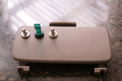

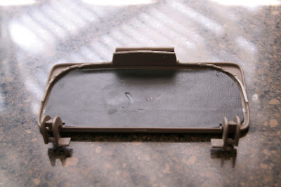

I've been kicking around the idea to modify the sunglass holder to house my accessorie switches for my Hella 700's, undercarriage lights (aka "rock lights"). Future additions will be bed lights, back-up/side lights, two electric cooling fans...
In anycase, here's a pic of the modified holder with some random switches I have just for show. Within the next week or so, I'll be re-running all the wires I have to the holder.

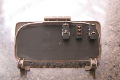

Additional updates. I've migrated my aux. light switches to the sunglass holder. Connected the 12V source to dome lighting. Which is constant. So, I can turn on the fan and aux. lights without the having to be in the acc on on position. The 12V source and the ground line is run, I believe the correct term is, in parallel. This makes it look a bit cleaner without a bunch of wires going through the opening. The switch lines were run independently to their respective relays. Starting on the left: driving lights, "rock" lights, electric fan. Here's the pics.
