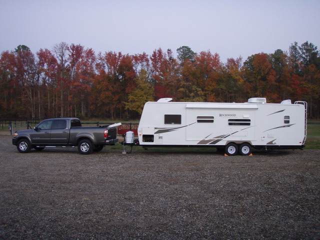

I went from a 16' pop-up to a 25' hybrid travel trailer to my current 32.5' (Rockwood Ultra Lite 2701SS).
I was concerned about the 2701SS length. I use the Equal-i-zer on this trailer and it does a great job. This trailer is designed well in that the axles are biased towards the rear of the trailer by about 2 feet so that helps control sway. It is lightweight at 5600 lbs loaded for travel. I have a hitch scale and was able to do some playing around on a trip to Ohio. I started at exactly 10% hitch weight and it was stable but wiggly. I went to a little more hitch weight and it got better. I then went with 750 lbs hitch weight and it was rock solid.
On the way home through the Shanendoah <sp> mountains, it got very nasty with high winds, freezing rain and fog. Worst conditions I've ever towed in. I saw no issues with directional stability. Couldn't see 50 ft in front of me and there was ice on the road and everyone was flying by me way too fast and the family was sleeping without a clue that I was squeezing the magic juice out of the steering wheel, but the trailer was stable.
So, this 32.5 ft trailer works with my 2005 Tundra. If the axles weren't that far back, I'm not sure it would work as well. If I don't keep the hitch weight up, it doesn't work so well. If I don't use the Equal-i-zer, it won't work so well. I know I am outside the guidelines for our 141" wheelbase Tundra, but the guidelines give you some leeway if you use a good quality sway control.
I will be adding a Hensley to the trailer once I find a job this summer. I picked a heck of a time to retire from the Navy.

I had no trouble with the Toyos towing my 24ft Wilderness but now that we are looking at up sizing I do have a concern about a larger tongue weight. It may all be a mute point because I would have to get an '08 to tow the '07 31 footer that we are getting a good deal on.
I did look at the Heartland seriously for a day but still with my '05 the smallest trailer did not have the floorplan we wanted and I would have to go to a min 30ft which may be too long according to Tom & Ray. The dealer said no problem, which may be true but I still think doing all the calculations that I still might be over my GCWR every so often. I am putting safety as my priority.
Plus Cdn $21000. to US $27000 plus other expenses figures into the picture BUT I sure did like the idea of having a wider wheelbase than the more conventional TT. Too bad I couldn't get a better deal. I would go to Montana to get the trailer no problem.
