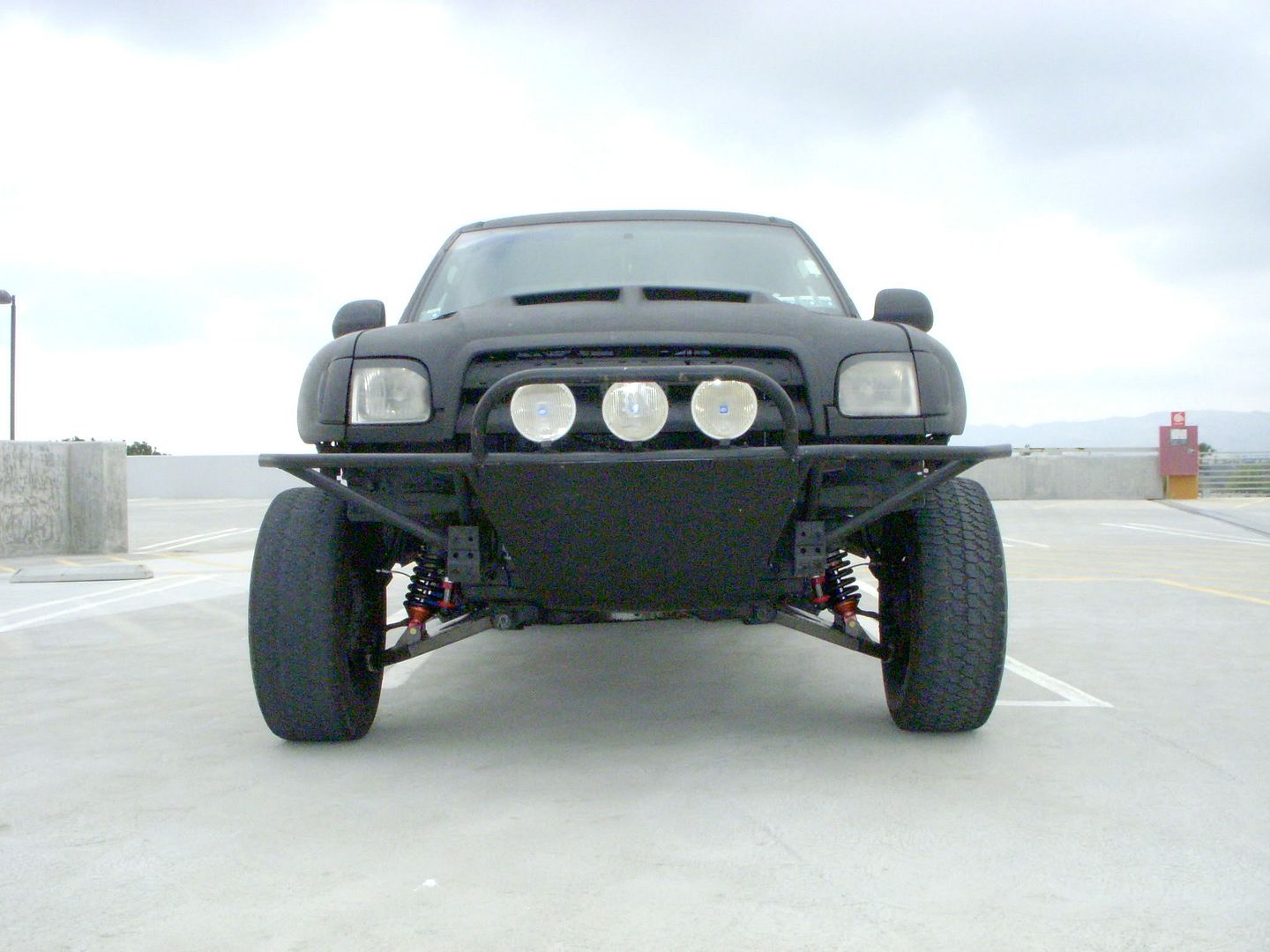

Jensen's double cab race truck.
Ian's clean 4x4 prerunner
