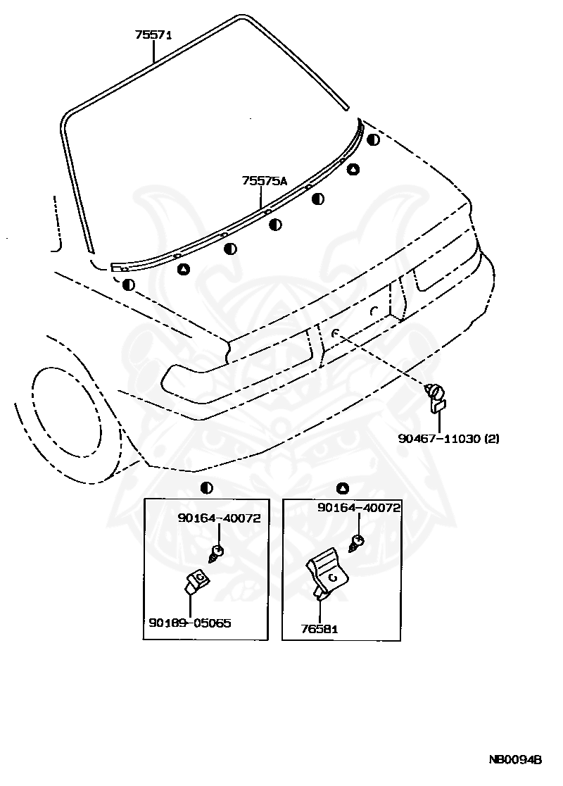

From pictures of it on line it appears to just be rubber weatherstrip basically. Have you tried a local auto glass place and see if they have matching material in a different length and getting some from them?

Get him to take a picture of it and post here what he wants. I know nothing about what he actually needs but pretty much every website that showed that part number has a picture of black weatherstrip curled up in a circle, and I know that window weatherstrip is softer rubber that goes around most of the glass. Hard plastic or metal cant do that.
If he has a leak, window trim of any kind doesnt stop that. They are purely for cosmetics. If he has a leak thats a break down in the urethane bead that seals the glass, that would require removal of the glass. What does he want it for?

As for the trim, again, the black piece that goes around the top and sides should be soft rubber. Years ago I think they use to be chrome trim so maybe thats what his is. We're talking about a 32 year old car so possible.
Look at this. Says chrome but it still looks like soft rubber.
I'm guessing he hasnt had it installed yet but if he takes it to a local glass place I gotta think they should have whatever it needs no?
