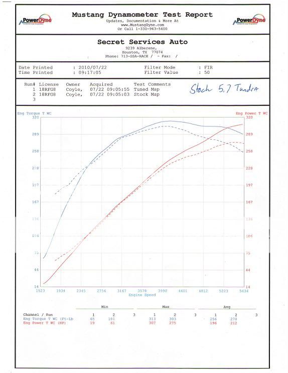

What octane fuel is this with? Also, did they show you your stock and tune air/fuel ratio?

There is seperate hardware to purchase in addition to the tune. There is no permanent modification that the dealer can see once removed so there is no issue with warranty work. This is an actual dyno tune, not a chip tune. The tune on the truck was made on the dyno with a Motec PLM Wideband connected to the truck and logging on the dyno. Top end power is very noticeable. It will be a while before fuel economy gains can be reported if any. No changes to transmission shifting can be made, only engine control. The hardware can control nitrous, methanol, and secondary injectors as well.

Don't mean to be a Debbie Downer, but I'm not all that impressed.
Don't these trucks get 320HP at the wheels STOCK??
The initial 275 Hp pull, that's nearly a 30% drivetrain loss.........seems a tad high.
By any chance are there any before and after track times???
Thanks for posting the results.

Secret Services Auto's dyno is known to read very very low...up to 15% lower than a Dynojet. The dyno is an eddy current loading dyno which applies a simulated load to the test vehicle. Much more accurate, much more consistent, much more realistic.

Its not like he's posting some outlandish results or anything so we'll wait and see. The the only other hardware available to tune the Yota's is from URD so maybe that is what he used. Its a Mustang dyno also so its gonna read low.

I was wondering the same thing. I am sure that I have seen some stock dyno numbers about the same that he has posted?

He was tuned on a mustang dyno, same as me. They show about 10% less than typical dynojets. Stock tundras dyno anywhere from 300-310 hp.
He was putting out about the equivalent of 302hp and 333tq stock. 338hp and 344 tq after the tune. Pretty good gains. That's an increase of 36 hp and 11 tq. Hope this puts it into perspective.
To the OP, why so secretive on the hardware/cost?

That's great results, interested in seeing more. If you can give us a few more details then they'll have my business. I'd like for em to do my tune with the cutouts open :)
