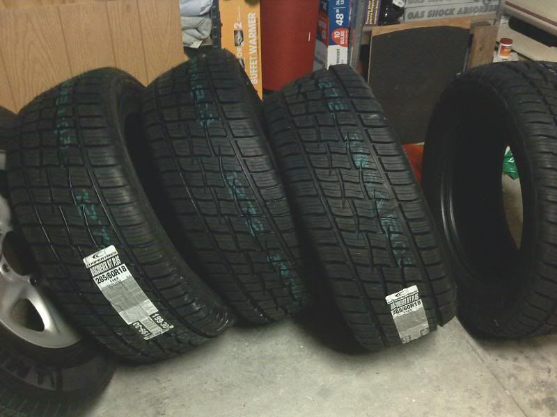

Cooper Discoverer H/T plus ... $440 locally. Treadepot was $463 delivered.
Your Tundra isn't lowered?:confused:
Yup, but I stuck with the 18" rims. These guys are 10" wide and being only 31 inches tall, I won't lose power either.
I'll try to get them mounted in the next week or so. I'll post a review after driving on them a litle while. We sold Coopers at a tire shop I once worked at and I sought these out because I was familiar with Cooper's quality. Hopefully, they won't disappoint me.

There is ample room between the lugs in the tread, so they should perform very well in the snow. In fact, the lugs are meatier than I expected. I hope they hook to dry pavement well.

I had walmart dismount my worn out Bridgestones today. I took the aluminum wheels home and mounted the Coopers using the TPMS sensors from the steel wheels. They do work if you turn them around backwards. If I have a flat, I just have to tell the tire jockey to unbolt the sensor and let it drop into the tire before attempting to dismount it. I brought them back to walmart for a lifetime balance. I'll try to get them bolted on the truck later this week.

Ok. I bolted them on today. Had a vibration in the front at 60mph, so I took a trip to walmart and they rebalanced them. The guy took a lot of time to get them right. He chased weights for quite a while on each one. After he was finished he said he'd like to drive it to make sure the vibration was gone. The Sams Club next door closed a few months ago and they use their parking lot for test drives. He said he'd try to get up to 60-65mph, but couldn't guarantee that he could hit that speed and slow down in time. I went inside and waited. He came back smiling. His first words were, "wow, that thing really runs." He was able to clear 60+mph and slow back down in the length of the Sams club parking lot. No vibration.
However,........I am fighting an intermittent TPMS lamp after resetting the TPMS. :td: It comes on intermittently after 10 minutes or so of "in town" driving. I guess it's time to scour the TPMS threads. Any input would be greatly appreciated.

Vibration is back. Front and rear. Looks like I might need to find a shop with a road force balancer. They handle very well on both wet and dry pavement. Straight line traction is pretty good considering the obvious traction issues the Tundra has. If it weren't for this blasted tire vibration, I would give them a perfect review.

I went through this a while back with Michelin LTX M/S2s...Balanced when installed and had vibration..Took them back to the tire dealer and he balanced them again..He let me watch and they looked perfect..Still a vibration..Took them to a different tire dealer and they did a road force balance...Still a small vibration...7000 miles and they still had the vibration.Had the oil changed at my Toyota dealer last week and told him about the vibration..They rotated and balanced the tires..Absolutely perfect....and each tire has very little weight..Tech said a couple of the tires were off 60 grams( I thought the weights were in ounces) and a couple 40 grams off but all were heavy..
No vibration al all speeds..
