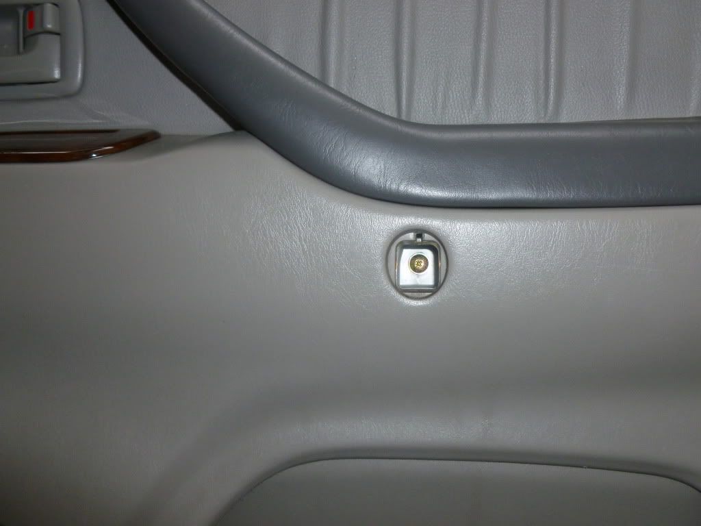

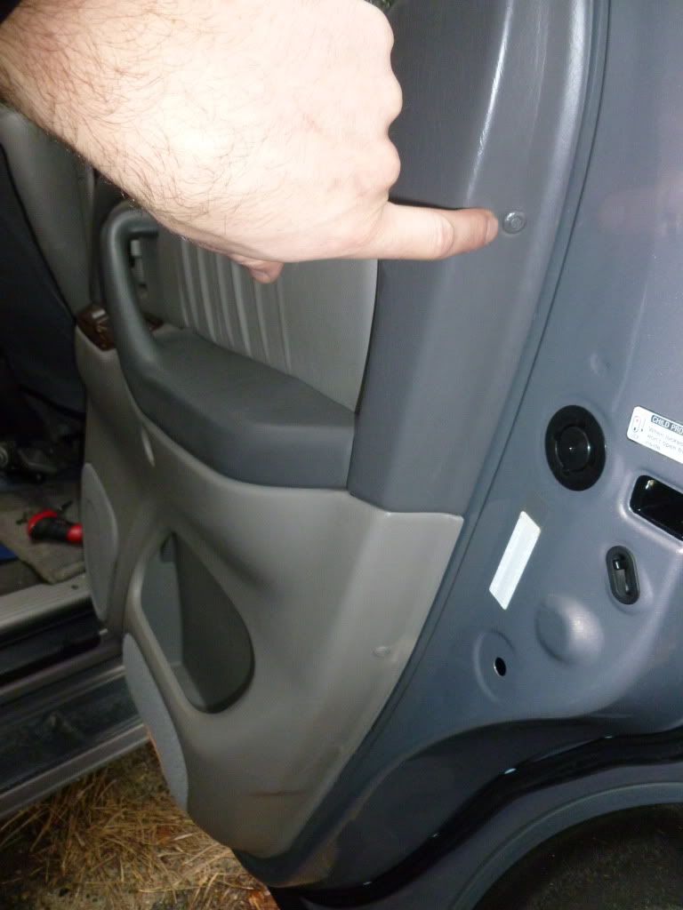

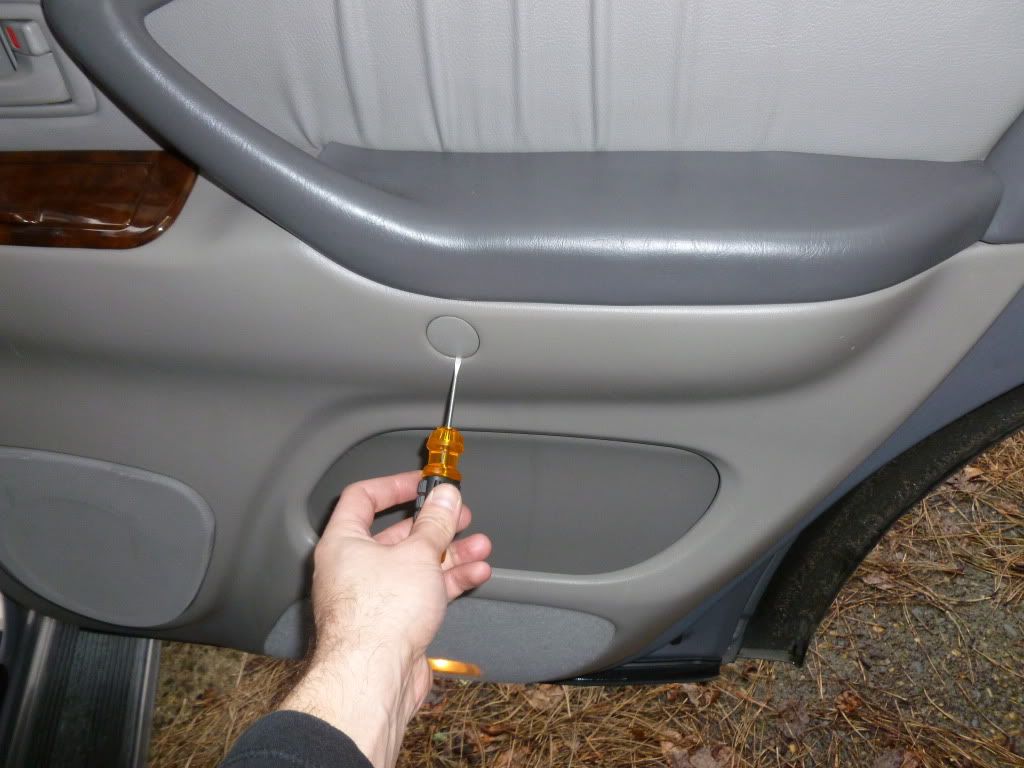

A.) Remove the plug using a flathead screwdriver...this hides one of the phillips screws; take the screw out:

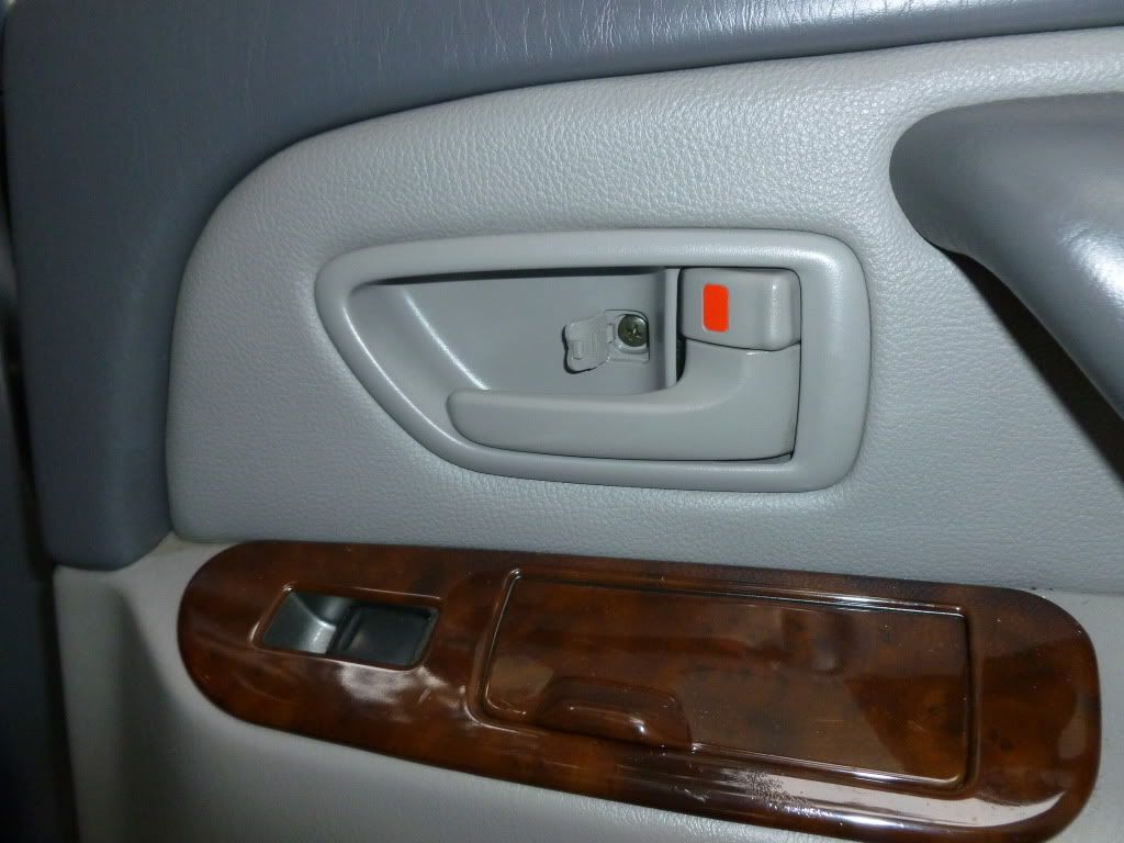

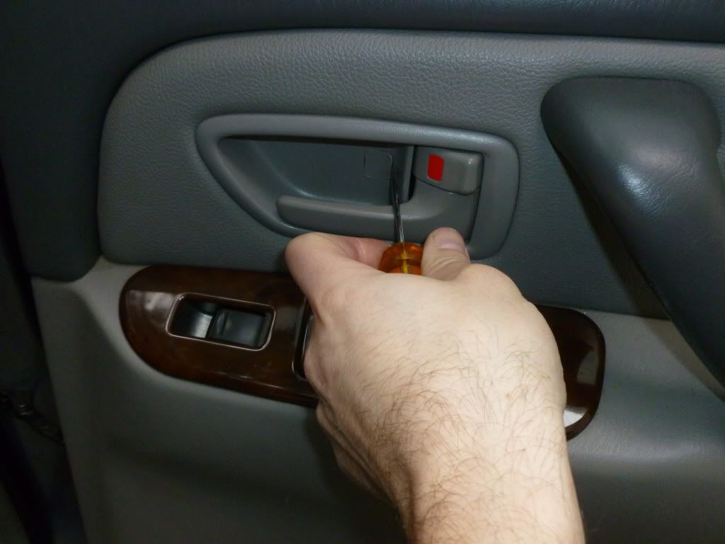

B.) Next, you need to take off the door handle bezel. This is the one point where you have to be careful as you can break the bezel. You need to; pry open a little flap door to reveal a phillips screw and take it out. Then take a flat head screwdriver and pry the bezel up and down from the pivot of the handle itself. Then the bezel is removed by pushing it twoards the rear of the vehicle while pulling on the handle. This MAY be the most time consuming part for you.

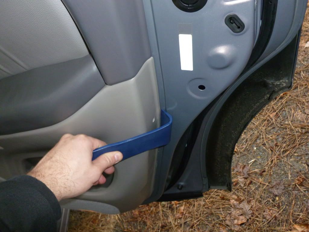

D.) Carefully, pry the door card away from the door. If you have one of the pictured tools, your job should be easier. I bought mine at Harbor Freight three years ago for $5 and guess what...hasn't broken yet. As you pry away, you should hear little clips start to snap out. I think there are anywhere between 8 and 10 clips all along the bottom and sides...NOT the top.
E.) Once all the clips are gone, lift up on the door card and it should come right off the door. As you pull the door card off, you'll need to disconnect two wiring connections. One is for the door light, the other for the window switch. Set the door card aside.

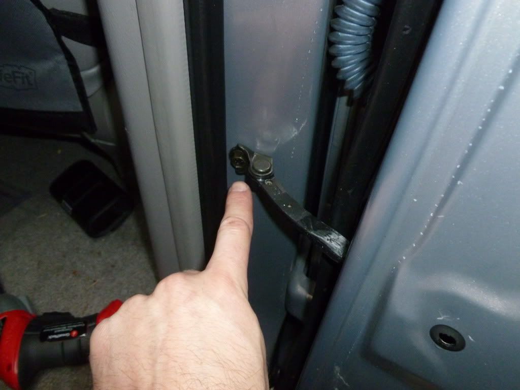

4.) Take out the 10mm bolt that is holding the door stay to the B-pillar.

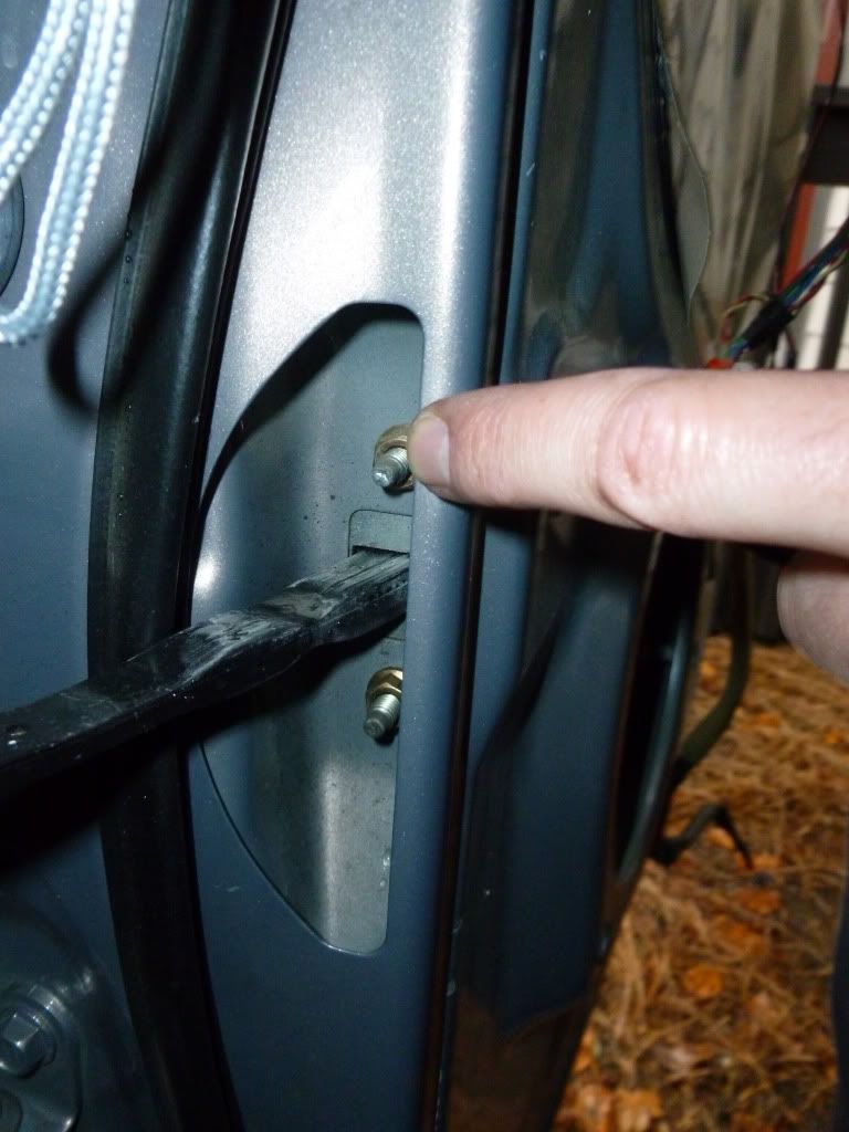

5.) Next, remove the two 10mm nuts on the front of the door.
6.) The old door stay should come right out. Reassemble in reverse order.
