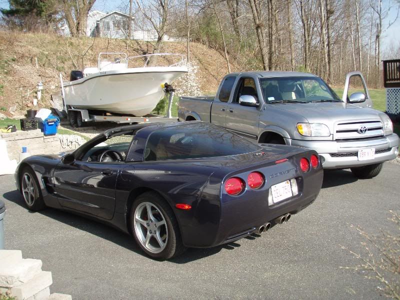

I've been towing my, at least 6,000lb boat/trailer for 4 years now. My 2004 has 101,000 miles on it and in all the towing, including when I first brought the boat home from FL to MA-1,600 mile run, I had never seen the "A/T Temp" light go on in the dash but do see it on start-up as part of the "dummy-light display".
Have any of you seen that light go on when towing?
Here is my load;
