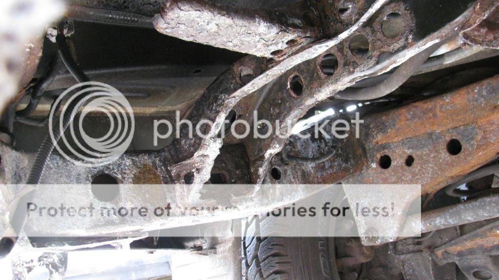

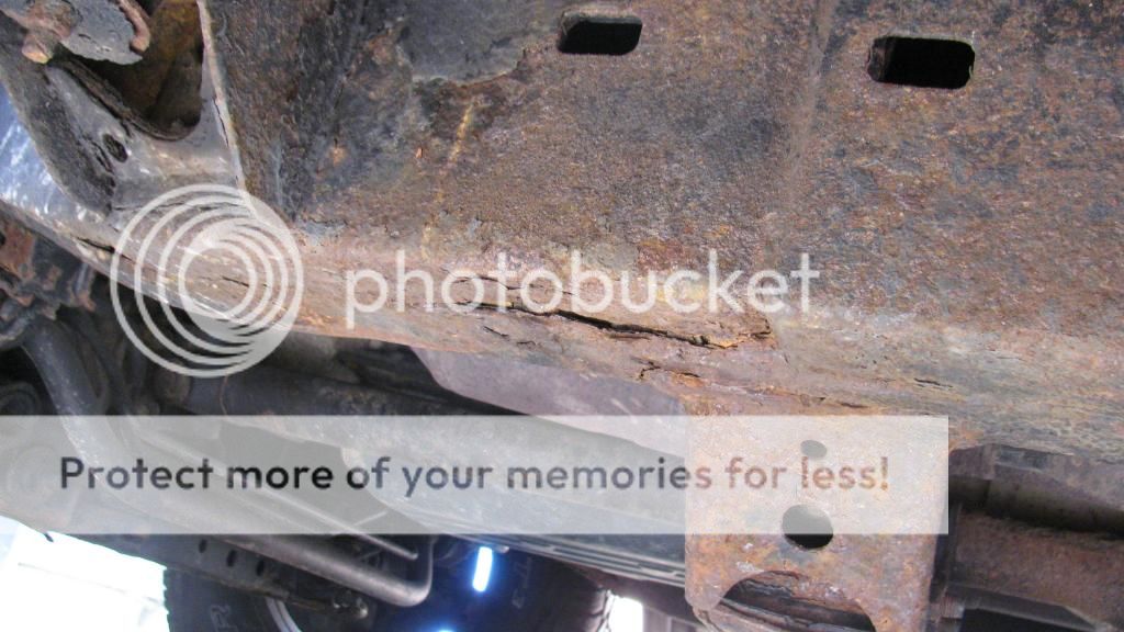

Bought a new to us 2001 Sequoia from a less than honest dealer here in Washington State. Not being in the rust belt, I did not notice the frame rust when crawling under the front of the vehicle to check for leaks. Once home I dropped the spare tire to my horror found SERIOUS rust. The Seq spent the first 8 years at least in the rust belt (Mass.)

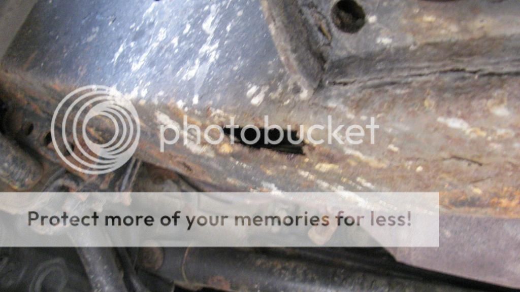

My wife takes the car into our local dealer tomorrow to start the frame replacement journey (initial inspection)....I have climbed under there and found holes bigger than the 10mm minimum Toyota requires, so I am sure it will fall under the service campaign. I am wondering what else they will try to upsell me, and if the hitch will be covered as it is just as rusted as the frame.. I guess we shall find out, I will update this post as new developments arise... wish us luck!

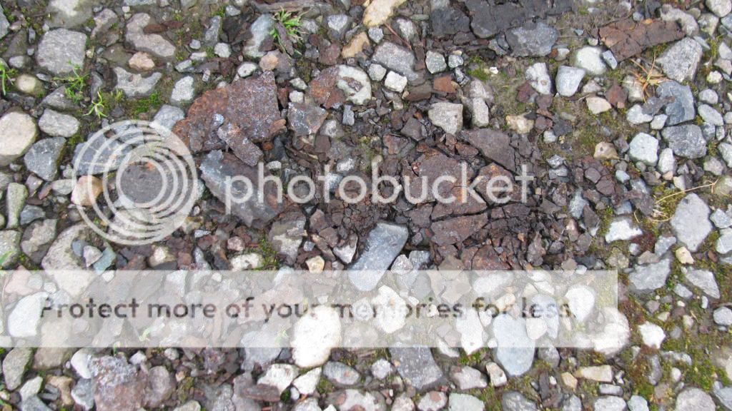

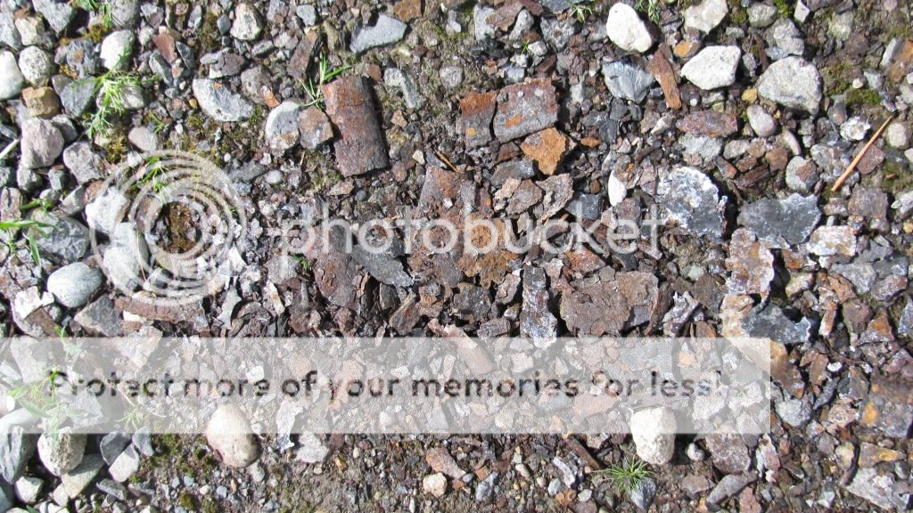

The two larger holes are right behind the front suspension where the frame "drops down" and levels out, the other pictures are of the rear cross member holding the spare tire up, and the pictures of the rust in the gravel are just what I used a putty knife to scrape off the rear cross member, back 1' of frame and the hitch...
