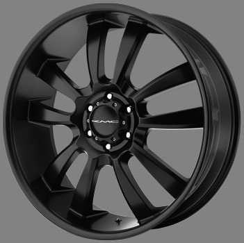

Here's what I ordered:
KMC Skitch 18x8 (need black lugs for this, do I order 14x1.5 spline types? And do I just install the TPMS straight into the KMC's? I have SR5 wheels)
295/70R18 Nitto Terra Grapplers
Beg Rug
Access Vanish Tonneau
Can't wait for it all to arrive! :bounce::headbanger::jimi:
