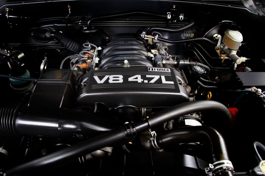

I want to keep it looking like this. Should I just wipe down with a cloth or is there something you can spray in the business to keep it looking nice?
thanks!

That's crazy clean. I'm afraid mine will never look that good for a couple reasons. Currently too dirty and laziness to clean to such detail. I'd love to see it look like that though! :cool:
Does yours look like that now? Or is that a picture you found?
I've seen some members with engine bays like that on TS. They are frequent fliers in the Detailing forum. One is a moderator, I think the detail job was prerequisite. They say you clean it with a pressure washer, dry it thoroughly, use a good glossy cleaner like 303 or something, and wipe it dry (no greasy finish). Probably takes a long time to get the impressive detail like you show in that picture.

thanks for the help.
yeah thats how it looks now. it came like that from the dealership, its an 06 with 27,000 miles on it...i thought it was a scam haha.

Whenever I wash my truck I pop the hood and hose everything off. My Tundra
is an '02 with 101K miles on it and it looks pretty much like yours does now,
without the shine. A good degreaser or Simple Green helps out too.

Followed up with a detail spray such as AmorAll or 303.

dont use wd40, it will dry out your plastic and rubber pieces, its alright for greasing metal but not plastic or rubber, stick to black magic or armor all

Looks good and detailed for 2006.
If it sees salt from snow, wash more frequently. If no salt, 1x or 2x a year
works well. Use garden hose (prefer to stay away from high pressure) to wash everything
down. Simple Green works well for me. Wipe it all down and some 303 protectant keeps it
looking sharp. A little wax on inner fenders and firewall adds to the look.
