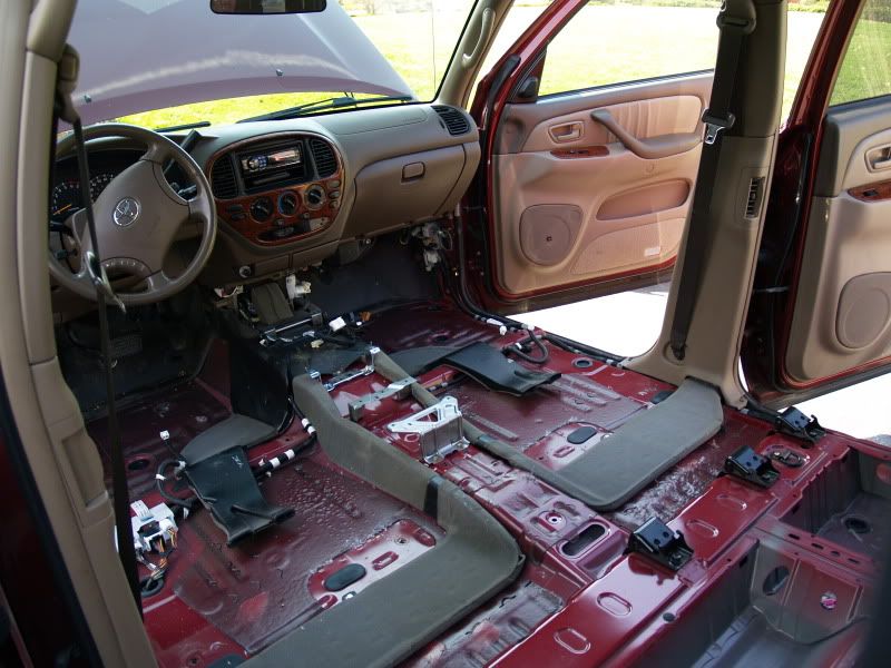

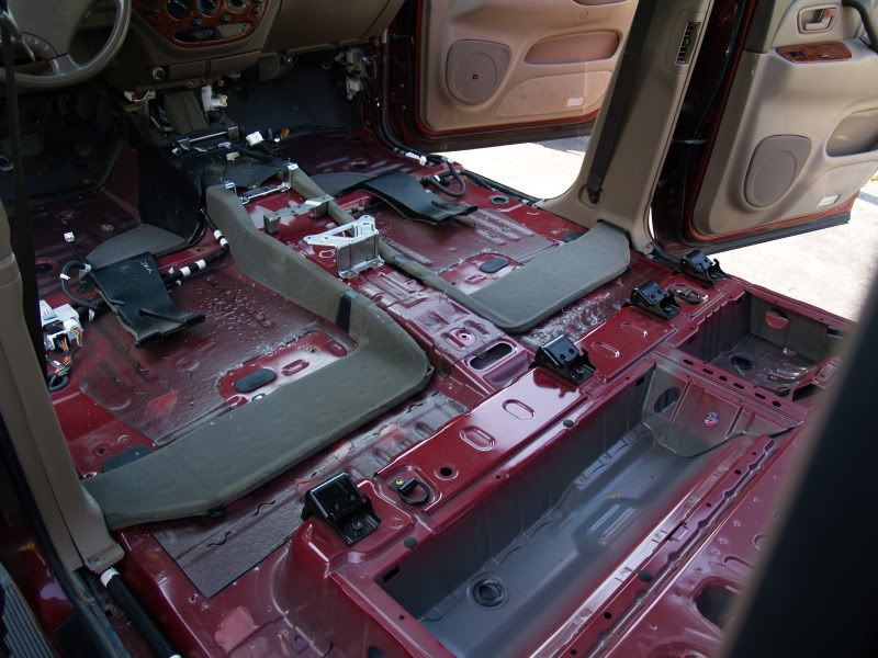

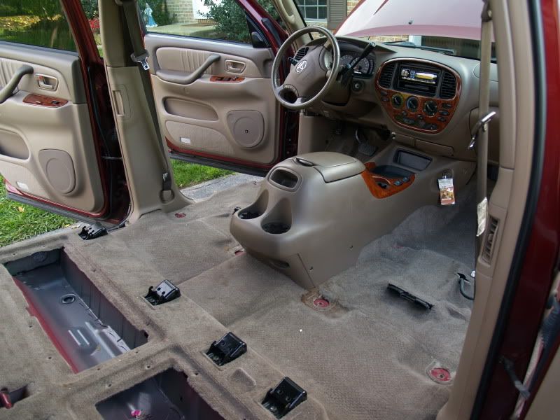

Some initial pics of starting the install...
Getting her stripped out...

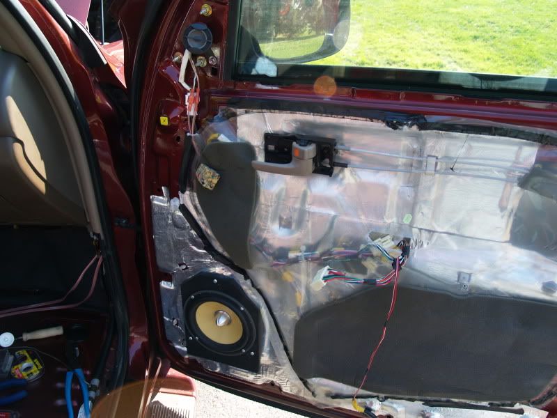

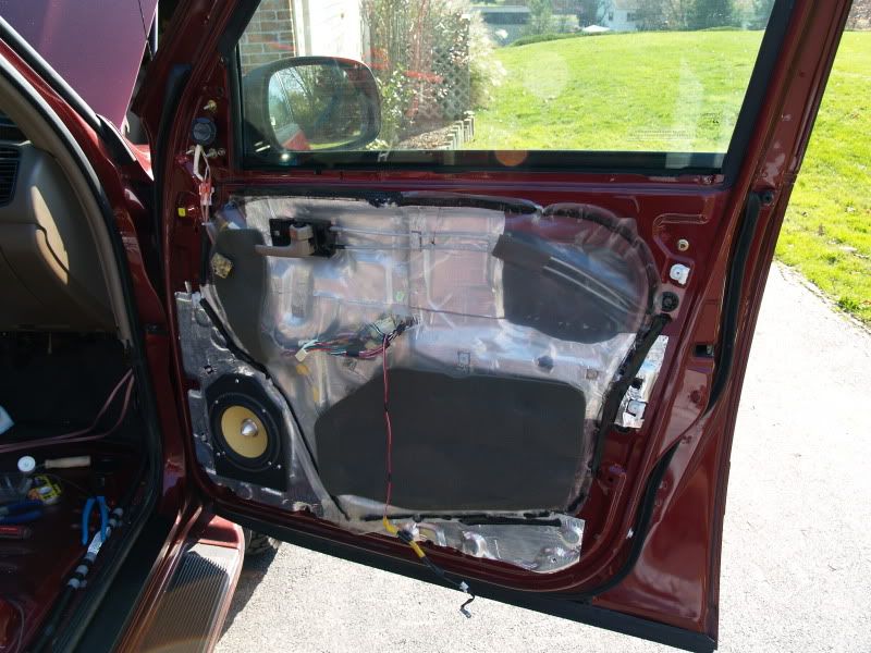

Got the doors deadened. Coated the exterior skin with two layers of R-Blox, and then one layer on the inner framework. Was sure to clean the entire area of install with brake clean and rubbing alcohol, and took the time to really put some pressure on it with the roller, and not get any bubbles. Also, I used MDF to make the mounting plate to mount the 6.5" Focals in the doors, as they need to be spaced off to allow the window to come down without hitting the magnet.

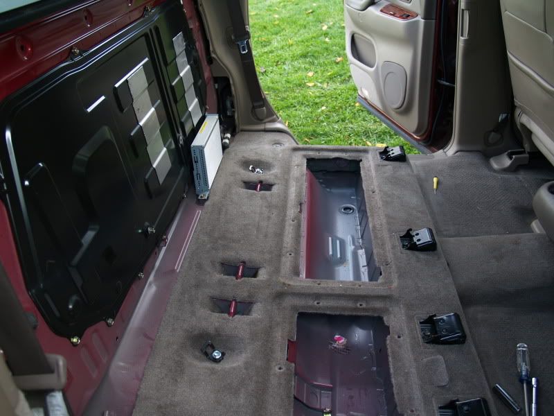

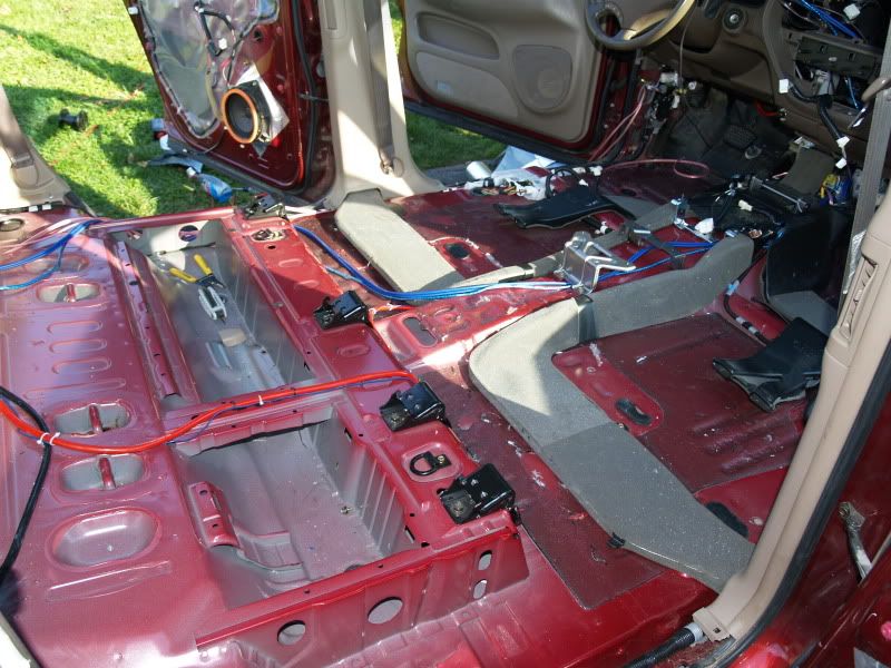

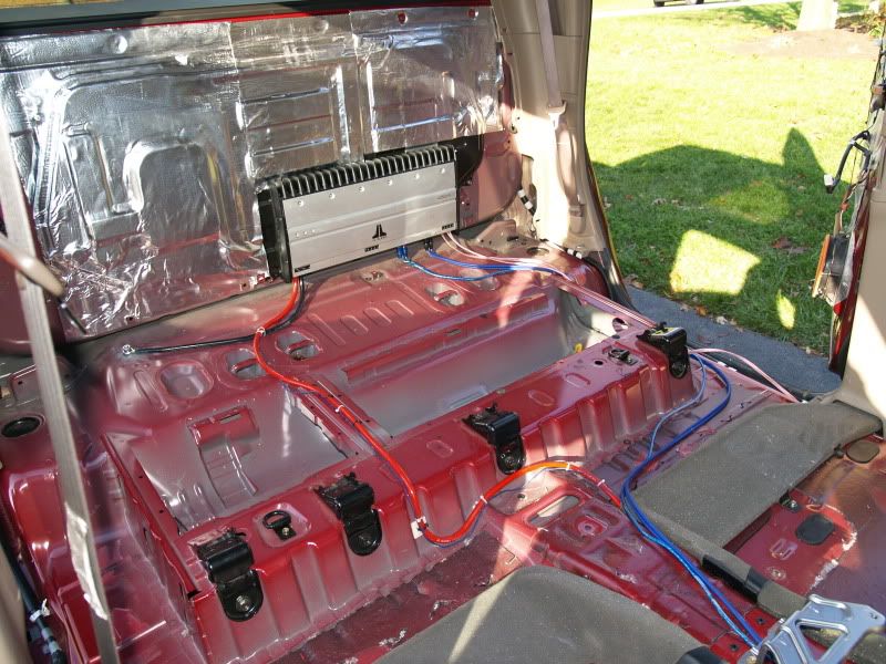

Got my wiring run, and the amplifier mounted.

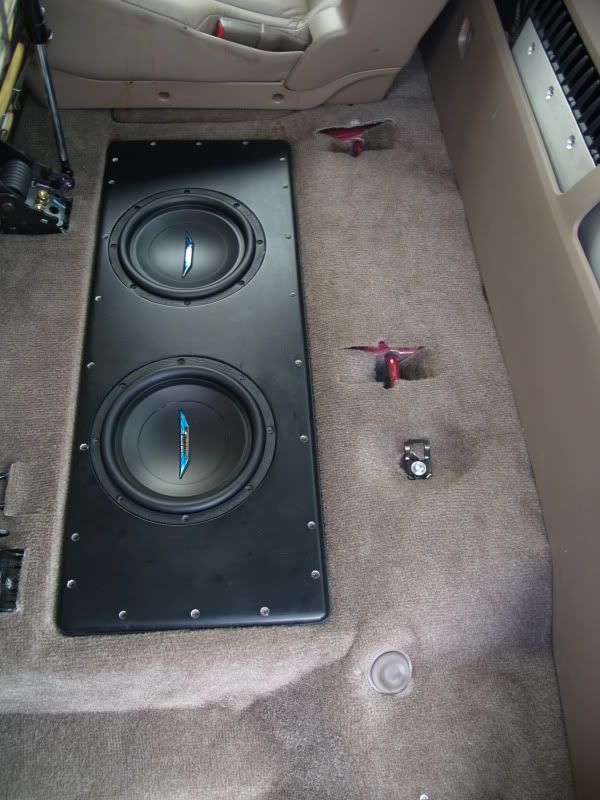

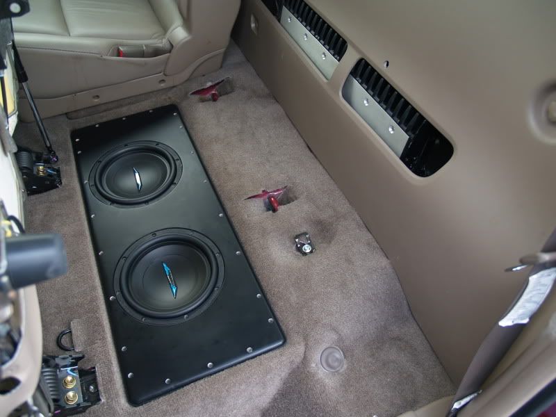

All installed, and ready to rock! Subwoofer enclosure is using the stock storage. I used silicone and "Great Stuff" expanding foam to seal the space. I used MDF and secured it to the framework of the space and then sealed it all up to close up the big holes. I used 3/4" wide weatherstripping on the top of the storage space to seal up against the 3/4" MDF top. I made the top from scratch using 3/4" MDF. I used a router to flush the subs into the top, and a round over bit to finish it off a little bit. I trimmed the surrounding carpet as not to interfere with the seal on the top of the enclosure, but have it tucked under the edge of the baffle for a nice look. (Don't mind the small hole above the amplifier. I was using my drill and a large bit to separate the two pieces that make the storage pocket, and the bit "grabbed" the plastic, pulling it through the front. Oh well, can't see it with the seat up. Also, I had to remove the decorative plastic piece from the underside of the seat as it would've contacted the woofers at max excursion. No good. Again, no biggie as you can't really tell with the seat down.

Only thing I would change is the routing of the power feed to the amp. Running the positive cable within such a close proximity to the RCA/Signal wires (under the center console / transmissin tunnel) usually leads to producing "alternator whine". If its working for you, great! If you start to pick up a high pitched whining noise as you accelerate, you have a weak ground, or need to space out those above mentioned wires. Looks great otherwise. Love the Amp and Speaker choices!
142 Posts
Discussion Starter #6
I know what you mean about power/rca location proximity. I was limited with the interconnects I had, and at that point, was kinda committed to the install... LOL. They actually cross at one point, but I made sure to route them so they cross as close to perpendicular as possible. No whine at all. Also, I used the JL grounding lug, which is a pretty beefy bolt/nut combo that really ensures a great grounding point.

such a nice install, and great choice of equipment. How did you mount the amp to the back wall? Just some self-drilling sheet metal screws? Does the "pocket" on the back of the plastic piece come off pretty easy?
thanks!
142 Posts
Discussion Starter #13
Oh, yeah, sorry. Yes, the amp is just metal screwed to the back wall of the cab.. ran them in to start the hole, backed them out, silicone caulked the hole, then ran the screw back through to help prevent rust. The pocket came off pretty easy.. used a large drill bit and drilled out the melted plastic "welds", and it popped right off. Be careful if you do that though, as my bit "grabbed" on one, and pulled through the front.. hence the small hole above the amp. LOL.. Oh well, can't see it with the seat up!!!
