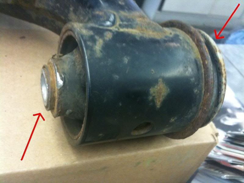

The next week I took my Tundra into my local Toyota dealership and explained to them that my alignment cams were bad and needed to be replaced. The service tech looked at me like I was crazy when I told her this. She said that cams don't typically need to be replaced until over 50,000 miles. (my Tundra has 28,000 miles). But she went ahead and got it into the shop and up on the rack. The serviceman called me back to him about 30 minutes later and proceeded to tell me that nothing was wrong with my alignment cams and showed me that he could turn and adjust them. He did an alignment and sent me out the door ($85.00 later). I drove away confused.
Needless to say, I called 4 Wheel Parts and explained to them what had just happened (in a slightly annoyed tone...I am sure). They were great and said of that was the case that they would go ahead with the install and not charge me for the alignment after the leveling kit was put on. I was happy with that response.

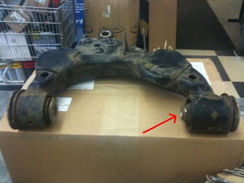

So....on February 17th, I take my Tundra into 4 Wheel Parts (for the third time) to have the Bilsteins, diff drop and wheels/tires FINALLY installed. My truck had not been in the shop 15 minutes when the service tech comes out looking annoyed telling me that my alignment cams are indeed still frozen up and unusable. Me = PISSED. I immediately get on the phone with my service person at Toyota and have the 4 Wheel Parts service tech explain to her exactly what is going on. She goes and talks to her serviceman and gets back on the phone about 10 minutes later telling me me that yes my cams are probably bad and need to be replaced (i thought they were good for at least 50,000 miles???) However...then she proceeds to tell me that these parts are not covered under my warranty since they are a "wear item". Me = SUPER PISSED. Since Toyota was not going to replace these parts for free, I went ahead and had 4 Wheel Parts order the new alignment cams as they said they would install them for a minimal charge since they were already going to have my truck up on a rack. They order the parts and we schedule a new install date for Feb. 25. I drive home frustrated and out an extra $300.00
So yesterday, I get up early and head into 4 Wheel Parts to have my bilsteins, diff drop, wheels / tires and new alignment cams installed. This time they at least had my truck in the shop for about an hour before I hear the service door open and the head tech coming out. NOT GOOD! He tells me....."we got another problem". OF COURSE WE DO! When he ordered new alignment cams, he did not order new lower control arms bushings and sleeves because he was confident he could use the ones that were already on the truck. As would be my luck....he was not able to save these parts and had to break them out of the lower control arm to get them removed. Here is a picture of my lower control arm and the bushing/sleeve I am talking about
The solution....$150 more in parts and another day of my truck in the shop. Oh...and to make matters worse...my truck is "beached" with the control arms off. So I have to call a buddy to come pick me up (25 minute drive) and take me home. I (did not drive but ) rode away feeling like if I would have know all this was going to happen, I would have never bought new wheels / tires.

So...first...what the service tech said was complete ********. These cams are destined to freeze eventually, because Toyota doesn't see fit to grease them, and they are a tight fit with just enough room to let water in and corrode everything shut. What the 4WP guys found is normal, unfortunately, and what Toyota said is just plain stupid. They are not a "wear item", they are a "not properly installed by the factory" item. Grease the new parts thoroughly before install, and it will never happen again. Regular black chassis/CV grease is sufficient, no need to get fancy, they just need a grease layer between the cams and the sleeves in the lower control arms, and of course the bolts.
If she said they should last 50K miles, I think you should be able to raise holy hell and get that dealership to replace them for you. What a bunch of crap. Mine froze a while back, and the tech was kind enough to let me know that they were frozen and that the truck could not be properly aligned until the problem was fixed. I have no idea how anyone aligned your truck with frozen cams...my guess is either the guy didn't do it right (which is common), or he just cranked away at the cams, not knowing that he was twisting the bushings in order to put them in the correct positions, which again means the guy who did the work is an idiot.
I wouldn't use that dealership again...or if you do, it's worth mentioning to the GM that he's got two people in the service bay with craniorectal insertion syndrome.
Don't feel bad, you would have had to do this eventually. Like I said, just make sure the new parts are greased, and if you're reading this and haven't greased this stuff on your own truck, go do it before your next alignment or it'll happen to your truck too :mad:.

Oh, it's actually really easy. Just throw it on jack stands, record (on paper) and mark (with paint marker) the cam positions (all four!), then pull them apart (carefully and one at a time!--the LCA is only barely being held in place without them, by the crenelations you can see on the faces of the metal sleeves), grease, replace, and reset the cams as close as you can get them to where they started, and go get it aligned. IIRC you need a 19mm wrench and a 7/8" wrench, or something along those lines...don't quote me on that, double check on your own truck :D.
If any are stuck, let the guy know in advance so he knows what he's working with, and sort out your options for replacing the frozen part.

Not worth the effort...once you put grease in there, it's not gonna go anywhere, and it'll take a long time for corrosion to start. I wouldn't sweat it. To give an idea...I did this about five years ago, drove through two Ohio winters and three Colorado winters, and they're still fine. Maybe I'll check the parts in another five years, see how they're doing.

i had the same problem with my cams on my 01 when i lifted it last month. 2 of the 4 were froze up. i went to a junkyard and just bought a whole lower control arm and ended up using that because it was cheaper than buying just new cam bolts from the dealer. i got the new bushings from NAPA. a 2 day job ended up taking a week.

I am happy to report that I have finally gotten my truck back from 4 Wheel Parts with everything installed and working properly. However, it did end up costing me about $500.00 extra ($300 parts / $200 labor) to get have the alignment cams, bushings and sleeves replaced. In the end, 4 Wheel Parts (Indianapolis) did a good job and due to all the problems and increased costs I encountered they even did the alignment at no charge.
