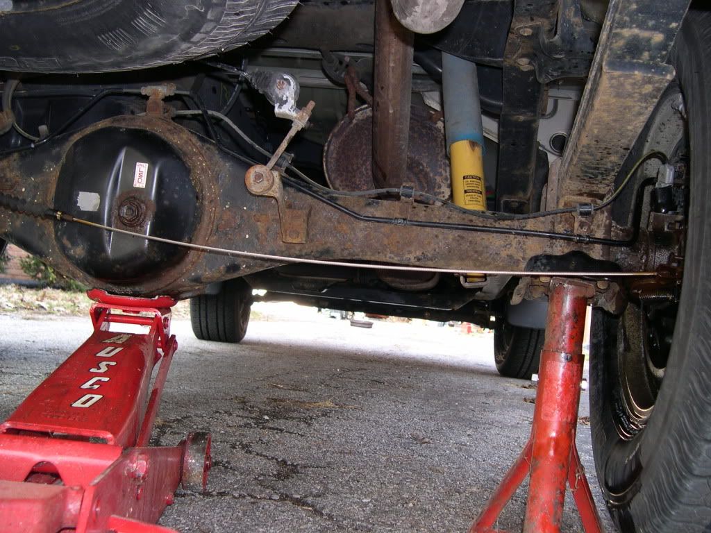

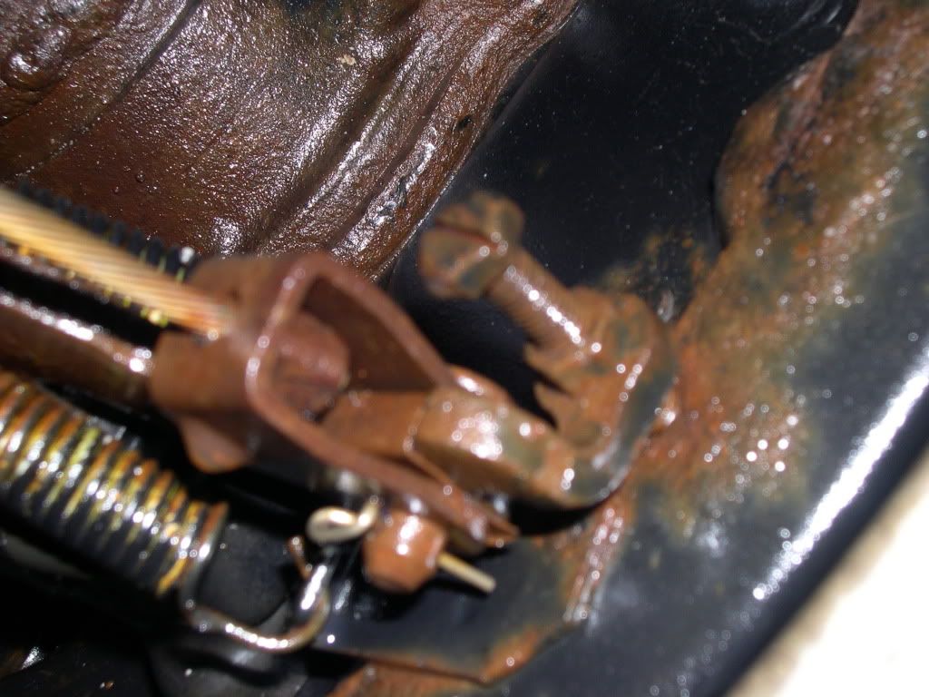

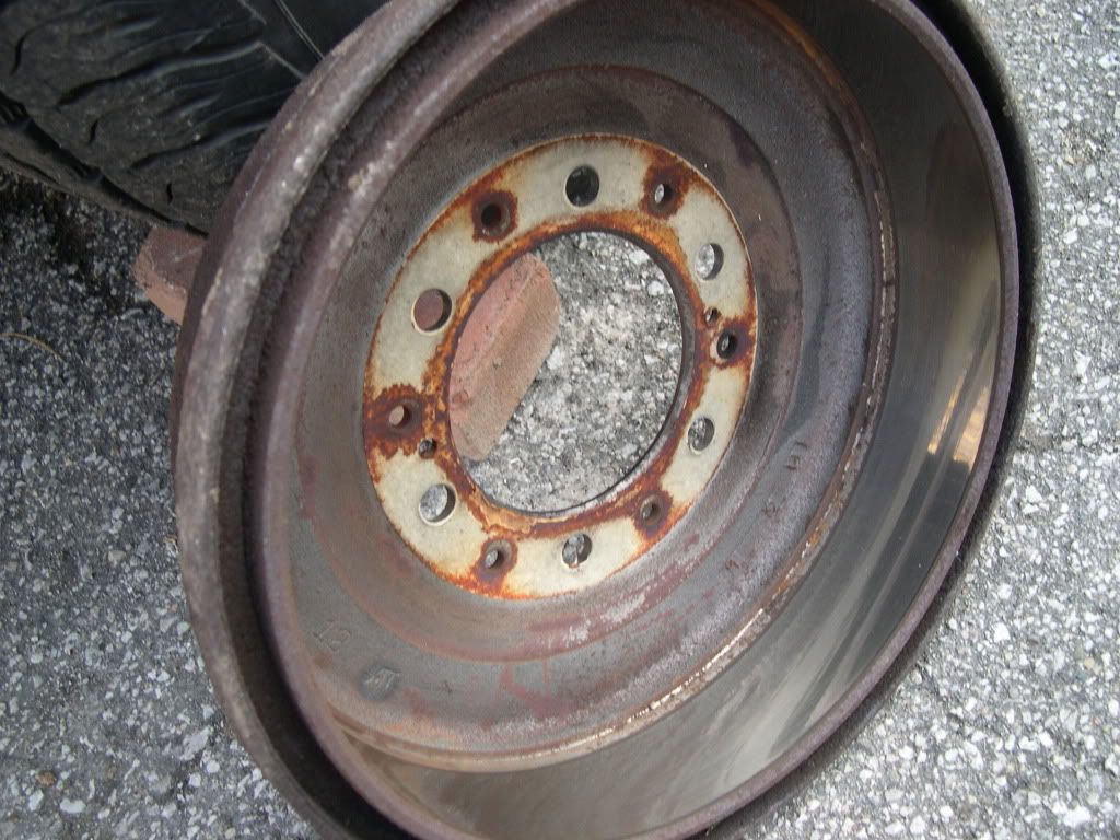

My parking break seems a little weak. I noticed the cable to one rear wheel sagging a little. The beelcranks are not frozen -- see photos. Seems like when I drive my rear breaks are not working as well as they should. I have photos I posted at Photobucket that I will link here.

It looks to me like you are getting uneven wear on the shoes, you have a significant amount of rust buildup on the drum's inside mounting surface, and you have quite a bit of corrosion on your e-brake bell cranks.
Go back to my earlier reply to you about brakes in the Gen-1 forum. It has all you need to know, especially about servicing the bell crank assembly.

If my bellcrank stop is not off the backing plate, why do I have a sagging parking brake cable on the right side?

What is under the rubber boot on the cable?
134 Posts
It does. I have not checked under the rubber boot. I am going to do a complete recondition of the bellcranks as soon as I get the paint and special grease this week -- there may be my problem -- under the rubber boot if it cannot flex and is all rusted up -- just thought about that. In the mean time I just got a code P0420, so have another problem to attend to. I think you may have solved the problem asking me about the rubber boot, it may be all seized up. I'll find out before too long and thanks.

Got it all repaired. One bell crank was frozen. I used the PDF guide in the Brakes Sub-Forum. Thanks to the author for that write-up!

Yep...did mine this weekend...been watching mine for 6 yrs after reading posts on it...they finally corroded to frozen...I'll post some pics later in my gallery but here is a quick one on the corrosion
