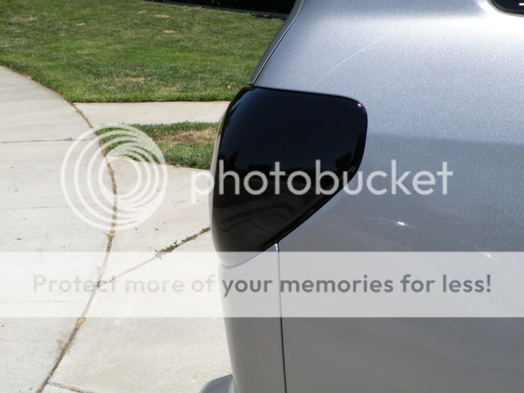

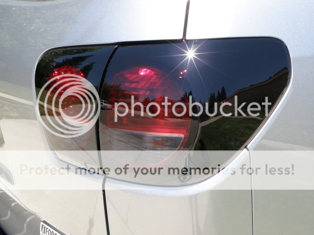

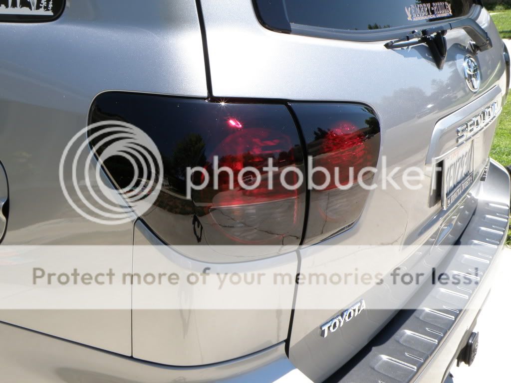

Just got done smoking my tailights. It was a week long project to get it done right. I used niteshades paint as the translucent black and 7 coats of aviation grade/aeronautical clear coat (jet glo/acry glo products). I sanded between the clear coats with 2000 grit paper and the final two coats went on like glass, no buffing required. The little spots you see on them in the close up picture is actually just dust. The taillights look like they were dipped not painted and they are like a deep rich candy apple color when you see them in person. The high quality clear coat paint is what made it all come together and the more coats applied, the richer the taillights looked. The cool part was masking off each taillight center and placing two coats of nightshades around perimeter and sanding paint edge with 1000 grit paper and then applying the 3rd coat of niteshades over the entire light assembly. This method allows the brake/running lights to be just as bright as the stock lights, but also hides that huge red looking reflector/lens on the remaining portion of taillights. The taillights now blend in very nicely with the tented windows, yet provide plenty of lights for night operation when desired. Let me know what you guys think and if you have any questions.

Pull interior rear plastic panels out that are located just forward of rear taillights. Note: one panel on right rear and two panels on left rear, one inside the other. Use a 1/4 drive ratchet and a 10mm deep socket and remove the two nuts located on each taillight. The ones inside are at the base of two long chrome looking studs. Reach in and turn bulbs counterclockwise and remove bulbs and wire harness from taillights. Go back outside and grab outboard taillights and pull straight aft and out and they will release from their clips. The rear inboard taillights are a little different and require you to remove them by sliding outboard and then reach around and disconnect the cannon plug from forward side of inboard taillights. Once removed use 1/4 inch wide fineline blue tape to mask around the areas of taillights you don't want to be blacked out. Use a fine blade to cut edges to follow contour of the light ring. Once the outline is masked-off, just use normal tape to mask-off the remaining center of taillight. Scuff sand perimeter with 600, 800, or 1000 grit wet paper. Wipe clean with mild isophrophal alcohol. Keep other harsh chemicals away because they will attack the niteshades (cheap) paint. After everything is clean spray two coats around perimeter and let dry 15 minutes between coats. Let first two coats of niteshades dry for at least 4 hours under heat lamps or over night. After niteshades black paint has dried, remove all masking tape and take 1000 grit wet sand paper and color sand (feather) in the painted edge. Wipe lightly with alcohol and cheesecloth towels and apply 3rd and final coat of nightshades over entire taillight assembly and let dry over night. Make sure each coat is applied in a different direction to prevent light spots or uneven spots. Next day apply 3 coats of high quality automotive/aeronautical clear coat paint of your choice over all taillight lenses and let dry over night. Note: mask-off all edges and holes that you don't want over spray to enter. Color sand all dirt, fish eyes, orange peel, or any other imperfections in paint job with 1000, 1500 and then 2000 grit wet sand paper and apply 3 to 4 more coats of high quality clear coat. I used a high end paint gun at 35 psi filtered air source and got the paint to flow out like glass in a controlled heated paint booth. Let dry over night and use 1500 grit wet sand paper to remove any dirt particles on final paint job and use 3M fineese-it polish with professional grade buffing wheel to remove the 1500 grit paint scratches. Guys I won't lie this is a lot of work to get it perfect. The key is quality clear coat. The clear coats is a 3 part mix with reducer and that alone cost me over $100. The niteshades paint is only $14 a can and it really is crap paint. I wish there was another high end paint out there that works like niteshades because the reducer in the clear I used was trying to eat that niteshades for lunch, that is why you better not rush this and make sure the niteshades paint is completely dry before working with it. Reinstall lights and enjoy!!! If you have any questions feel free to ask.
