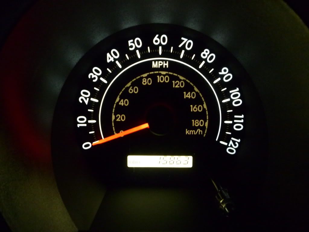

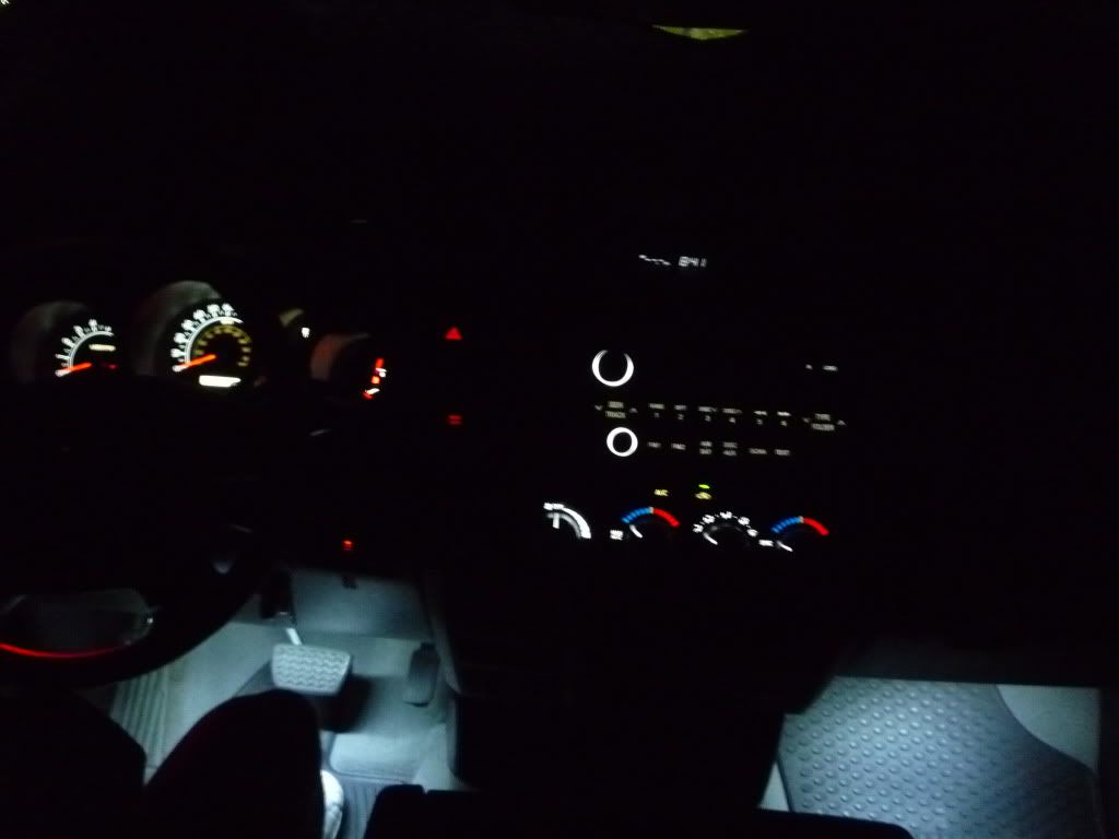

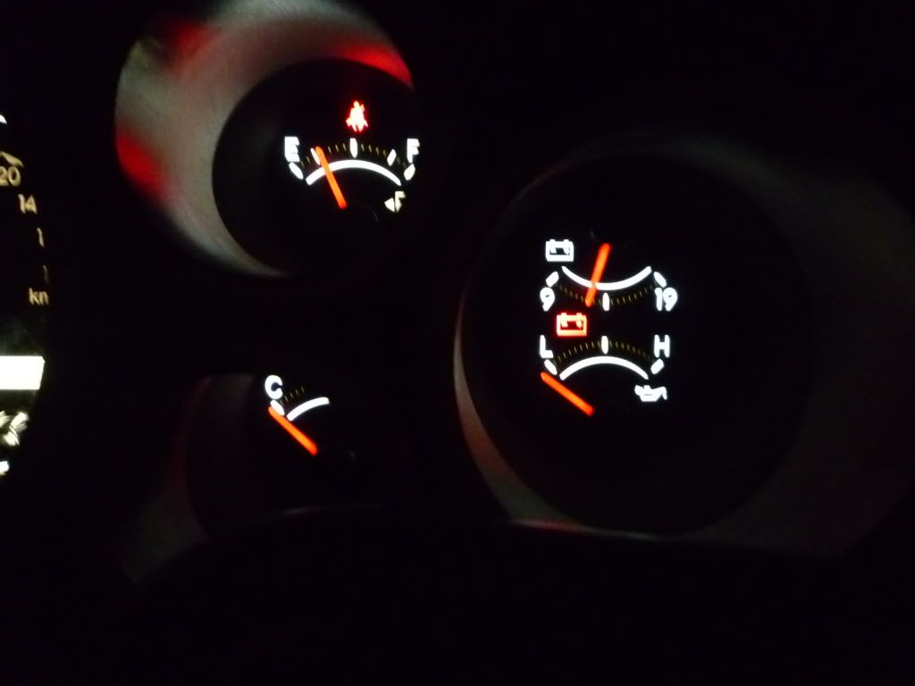

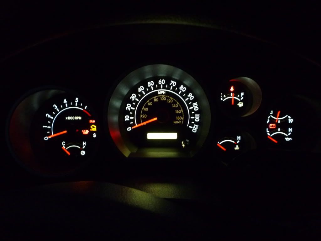

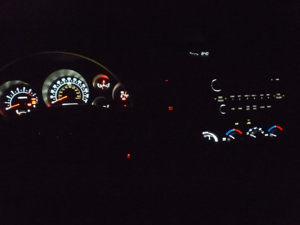

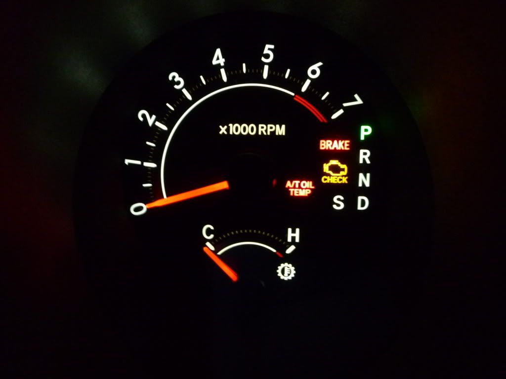

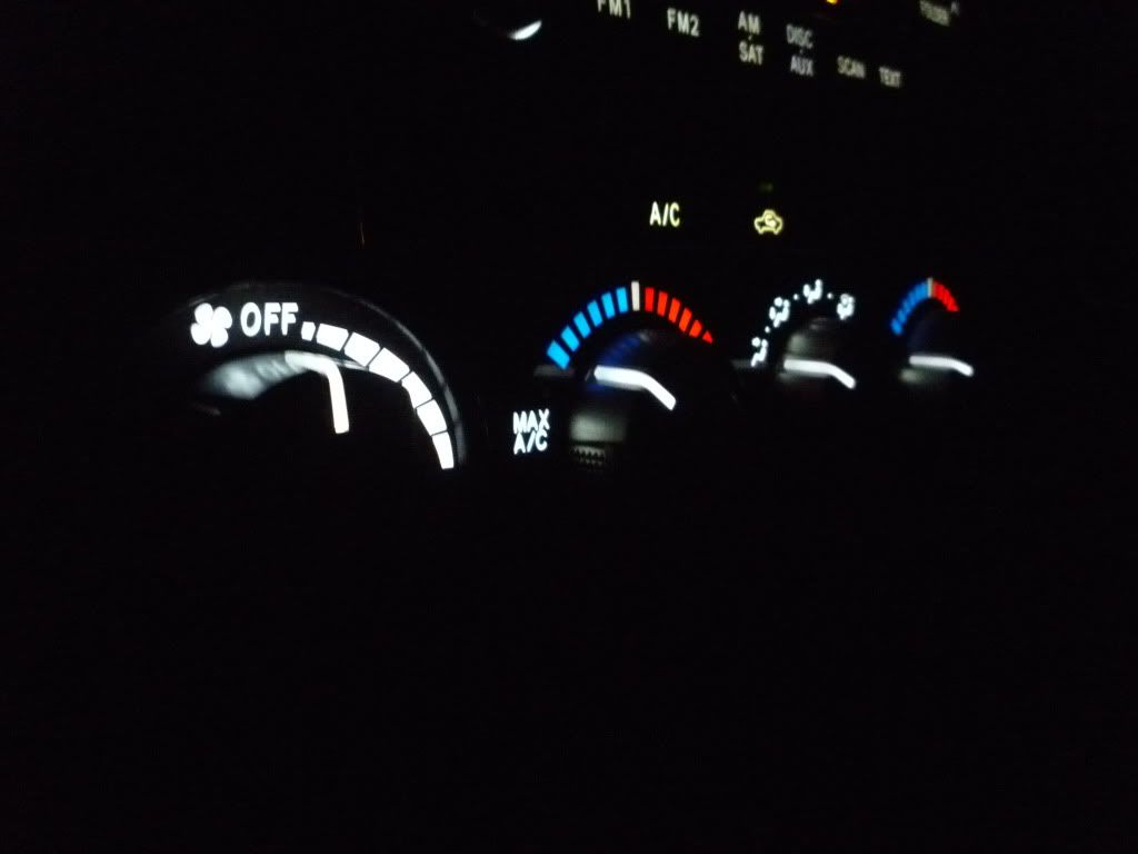

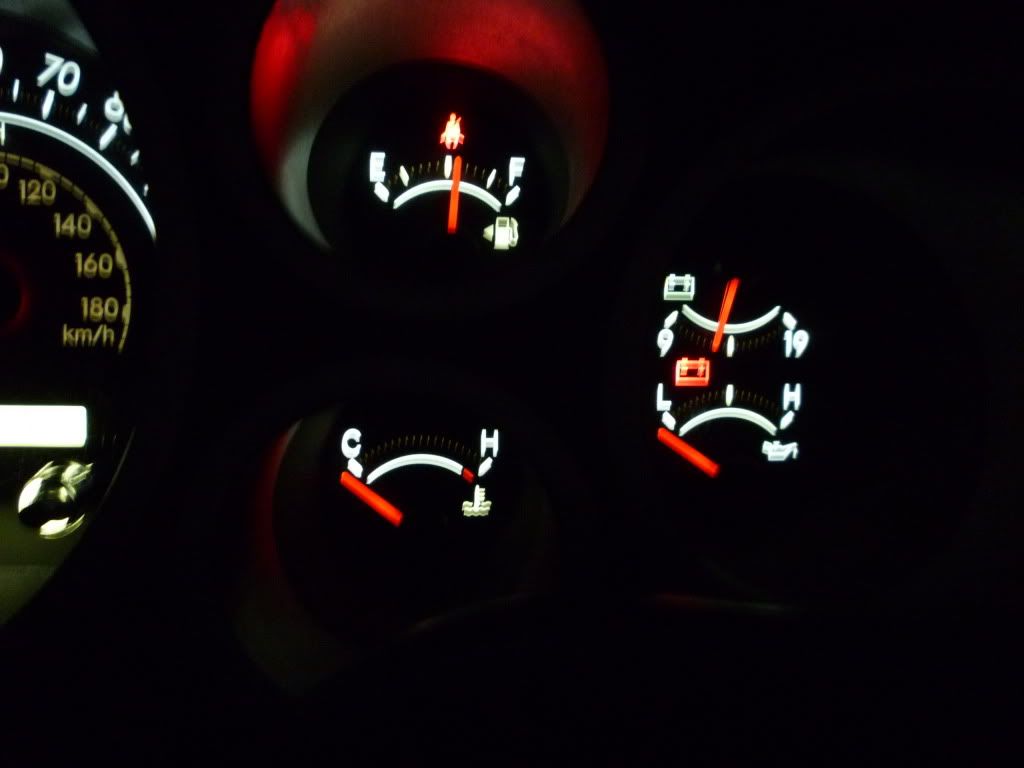

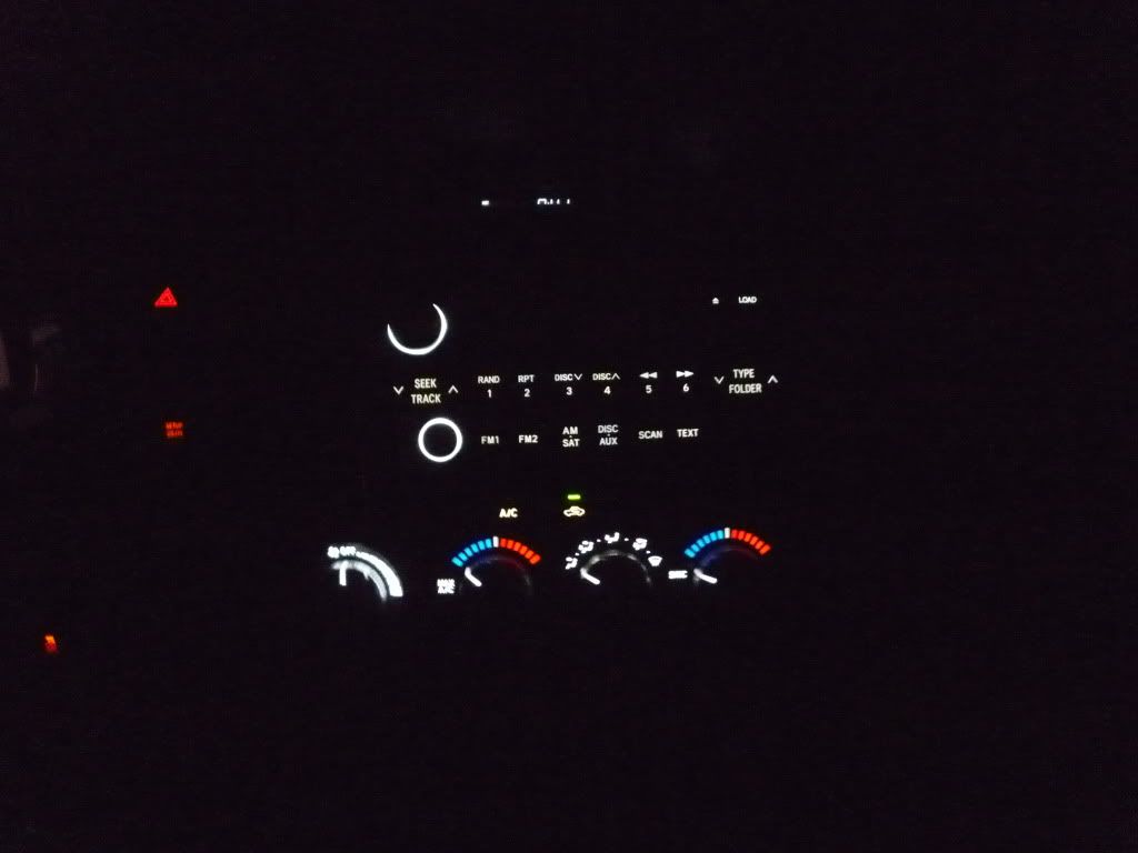

Prepare to be in awe mates...
I previously bought some Oznium.com white leds and swapped out my gauges. They were too warm white for me..
BEFORE AND AFTER PICS comparing oznium white leds to ebay whites
Before
After
Before
After
Before
After
Before
After

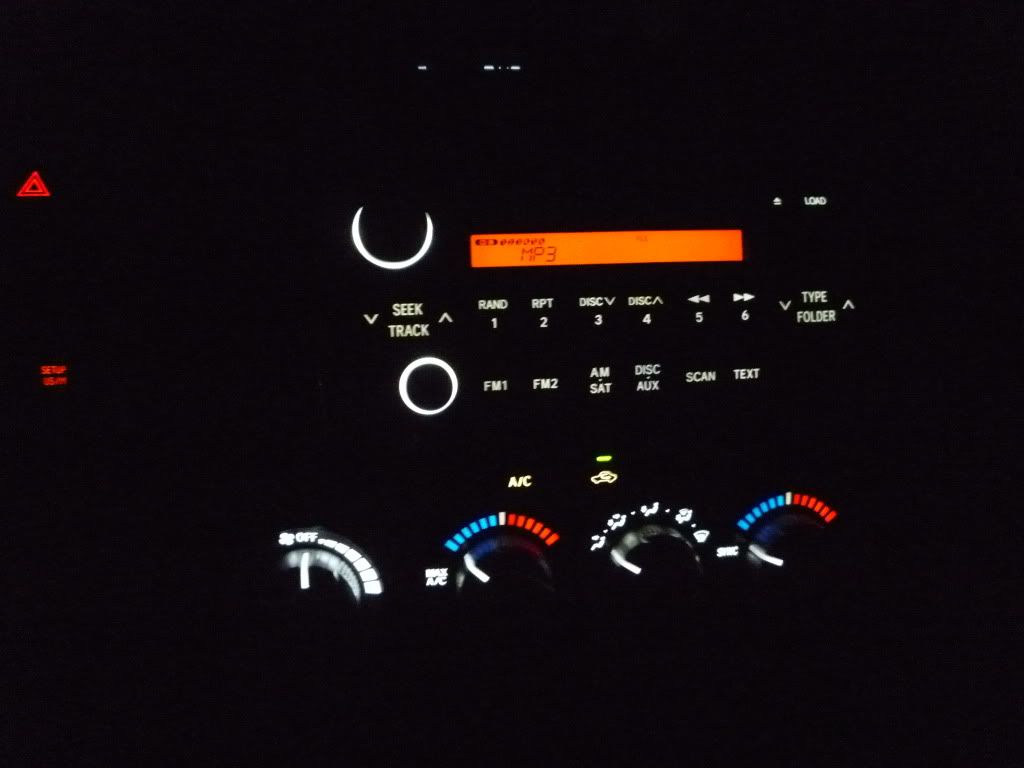

My beautiful radio and hvac

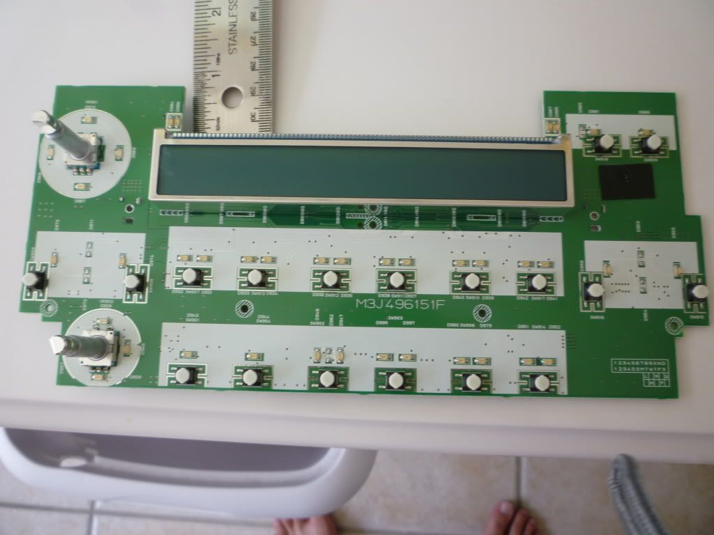

The damn led screen is soldered on there so I couldn't get under :mad:
Picture of the radio apart
All of this with ebay LEDS!
I made sure and bought the ones with a high mcd number; all my leds were rated at 2500-3000 mcd.
Part #'s
HVAC and Gauges used PLCC-2 leds http://www.toyotatundraforum.com/electrical/2276-dash-led-swap-goodbye-amber.html << Good write up
Radio used 1206 (extremely small) Buy 50
I can try and answer and Q's

Nice job! Love the white. I know many folks go with blue, but the white is definitely easier on the eyes and more "OEM." Clean, clean, clean! :tu:
216 Posts
Sweet. That looks very clean and I like that lower footwell lights too. Nice job.

The LED's under the radio display can be gotten to. You just have to solder de-wick the metal shroud tabs on the other side and remove it. Then you just "gently" pry back the LCD header and being careful to not break it.

i prefer the orange.....btu then again i dont see any appreciable difference between the before and after in this thread.....they look very similar to me, too close to have even messed with it. and its waaay too much work to just change the color IMO. back in the day when there were two or three screw in bulbs (non LED) and u could change it with the rubber condom looking covers and make it look however you wanted, i did it...but certainly not worth the effort nowadays IMO...but it does look good, dont get me wrong. but i think the white lights would get on my nerves at night.
oh and you missed one....what about the SETUP US/M button....having one orange backlight in the mix is a no no hahaha.
Good job.
Good catch - I just noticed that. That and the traction-control switch down below
PH - looks like you still need to complete the "add-MPG-buttons" mod.
yeah i hear some goofball did a whole write up on the how to add mpg buttons...can't remember who.........:devil:
