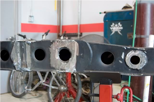

Hey so heres the next update guys.
Why the truck had what I called unsafe handling before was for a few reasons. The geometry of the link setup was all wrong. The Panhard bar setup was all wrong as well. Basically it was a pure drag setup. The front has 10 inches of travel and the rear had 5 inches of travel. In a corner as soon as the inside tire drooped all the way it would lift off the ground. You can only imagine how VSC dealt with all of this.
So about the new company... Viking Offroad Engineering. The owner/fabricator, Sean Person, has a Mechanical Engineering degree from CSUN. All the work thus far has been impeccable. The customer service is right on par with the welding. I get at least 2 calls a week to be updated on the progress.
Viking Offroad Engineering is building a file on this 4 link build for our tundras that way he can easily create a weld on kit. He is making templates and everything is saved on CAD.
I'll have a lot more pics on Monday :D

Alright well here are some more recent pictures just taken from my camera phone. I'll have to update at the end of the week when I get back in town.
The Tundra now has Camburg upper control arms and Mcgaughys spindles. I also just came up on a beautiful set of 3 piece forged 22's courtesy of Supramn who really hooked me up :D
I beginning to think I should call this Operation Traction! 4-link rear, 305/40/22 Dunlop SP Sport Maxx GT's, an auburn gear LSD and then the fuel cell and two 40lb batterys all mounted behind the axle. Plus I'll also have a spare mounted in the bed right above the axle and thats about 80lbs. Can't wait to see how this bad boy hooks up!
